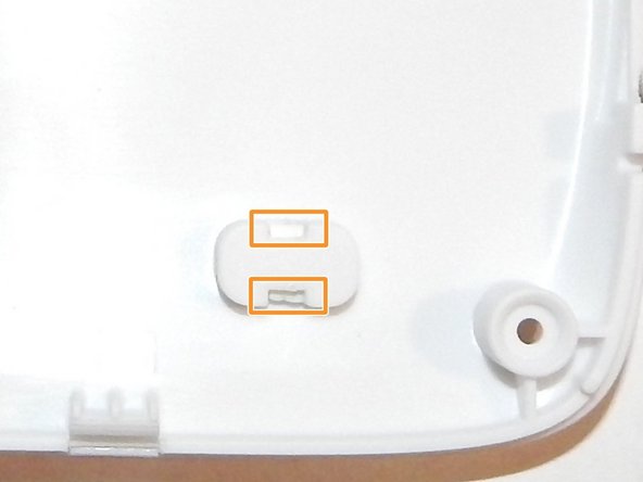

    1. Arnova 7K G3 Rubber Feet Replacement, Rubber Feet: step 4, image 1 of 2 Arnova 7K G3 Rubber Feet Replacement, Rubber Feet: step 4, image 2 of 2
      • Locate the two lower bumpers on the back cover. These are the rubber feet.
      • Flip the cover over to reveal the inside.
      • Locate the two rubber tabs, there are two for each rubber foot. They are located on the inside of the cover.
      Ask FixBot
    2. Arnova 7K G3 Rubber Feet Replacement: step 5, image 1 of 1
      • Push the two tabs on each foot down using the pointed end of a spudger.
      • It may take some force to push in the tabs. Prying with the pointed end of the spudger and wiggling the tab free may be necessary.
      Ask FixBot
    3. Arnova 7K G3 Rubber Feet Replacement: step 6, image 1 of 1
      • Flip the cover back over so you see the outside. Remove the rubber feet if they have not already fallen out.
