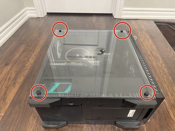

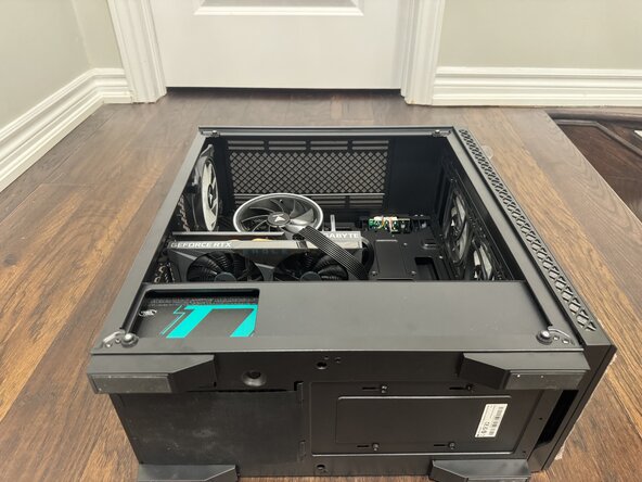

      • Turn off the PC using the power switch on the back and unplug all cables.
      • Lay the PC on its side and unscrew the glass panel to access the internal components.
      • Place the screws in a safe location.
      • Remove the glass panel.
      • Please download the necessary drivers for your new Wi-Fi card before performing any work on your PC.

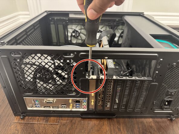

    2. Armoury RTARU00047 Wi-Fi Card Replacement: step 2, image 1 of 3 Armoury RTARU00047 Wi-Fi Card Replacement: step 2, image 2 of 3 Armoury RTARU00047 Wi-Fi Card Replacement: step 2, image 3 of 3
      • Use a Phillips #0 screwdriver to remove the back panel screws circled in red.
      • Loosen the screw that will secure the new Wi-Fi card.

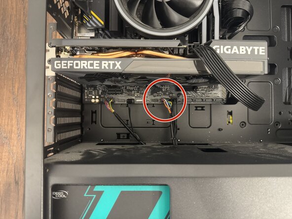

    4. Armoury RTARU00047 Wi-Fi Card Replacement: step 4, image 1 of 2 Armoury RTARU00047 Wi-Fi Card Replacement: step 4, image 2 of 2
      • The Armoury RTARU00047 comes with an integrated WiFi card that is hidden within a module in the bottom of the PC case.
      • Disconnect the Wi-Fi card cable from the USB header.
      • Identify the Wi-Fi cable by locating the multicolored wire beside a black cable.
      • Note that the cable connects to the USB header labeled “USB 3,” which will be used for the new Wi-Fi card.

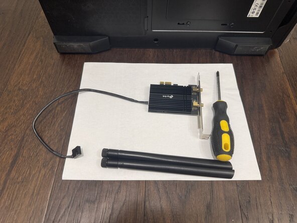

    5. Armoury RTARU00047 Wi-Fi Card Replacement: step 5, image 1 of 3 Armoury RTARU00047 Wi-Fi Card Replacement: step 5, image 2 of 3 Armoury RTARU00047 Wi-Fi Card Replacement: step 5, image 3 of 3
      • Your new WiFi card will come with the card, and a pair of antennas that you will screw in the back of the PC.
      • The PCIe slot will be vacant right beside your SSD, and under the fan.
      • Insert the new WiFi card in the PCIe slot.

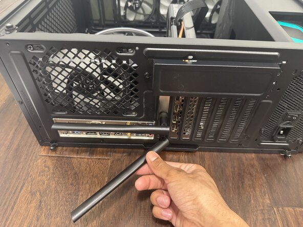

      • Screw in the antennas.

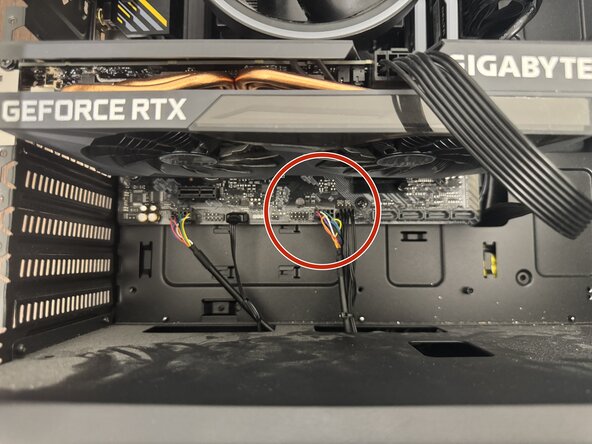

    8. Armoury RTARU00047 Wi-Fi Card Replacement: step 8, image 1 of 3 Armoury RTARU00047 Wi-Fi Card Replacement: step 8, image 2 of 3 Armoury RTARU00047 Wi-Fi Card Replacement: step 8, image 3 of 3
      • Connect the new WiFi card’s cable into the "USB 3" heading.
