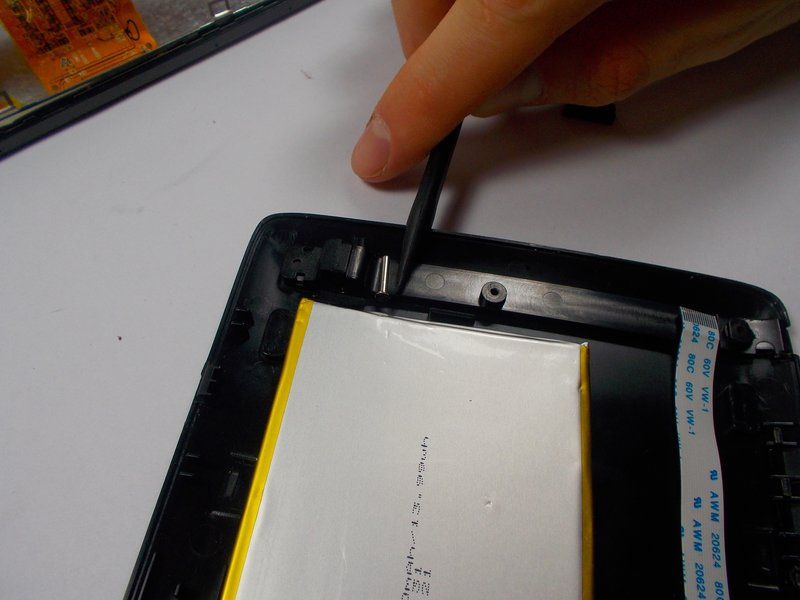

    1. Archos 70b Stand Replacement, Stand: step 4, image 1 of 1
      • Remove the small blocking between the battery and stand
      • Push the pin towards the battery until completely free
      Ask FixBot
    2. Archos 70b Stand Replacement: step 5, image 1 of 1
      • Remove stand
      • The stand should easily slide out once the pin is removed
      Ask FixBot
