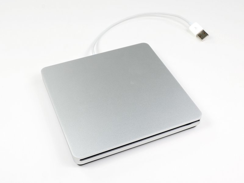

A simple guide to replacing the optical drive in the external optical drive sold by Apple for the MacBook Air. If your optical drive breaks, use this guide to replace it.

    1. Apple USB SuperDrive Optical Drive Replacement, Optical Drive: step 1, image 1 of 2 Apple USB SuperDrive Optical Drive Replacement, Optical Drive: step 1, image 2 of 2
      • To open the SuperDrive we must remove the lower case.
      • The lower case is attached by 8 clips.
      • 6 along the sides
      • 2 on the back
