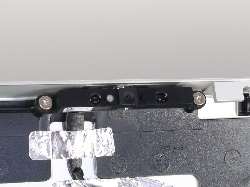

    5. Apple Thunderbolt Display Webcam and Mic Replacement: step 13, image 1 of 3 Apple Thunderbolt Display Webcam and Mic Replacement: step 13, image 2 of 3 Apple Thunderbolt Display Webcam and Mic Replacement: step 13, image 3 of 3
      • The webcam is held in with two screws and a connector
      • Unscrew the two screws holding the webcam in place with the TR 10 screwdriver.
      • The webcam is now free from your display!
      Ask FixBot
    6. Apple Thunderbolt Display Webcam and Mic Replacement: step 14, image 1 of 2 Apple Thunderbolt Display Webcam and Mic Replacement: step 14, image 2 of 2
      • With the webcam removed, the microphone is now visible.
      • The webcam is held in place with a plastic clip that has foam adhesive stuck to the casing.
      • Use a plastic spudger to pry underneath the clip and separate the clip from the casing.
      Ask FixBot
