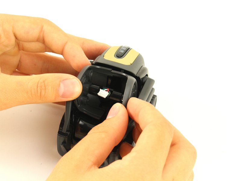

      • Pull apart Vector's head. It should separate down the middle.
      • Remove the screen protector by gently pulling it free from the two face halves.
      Ask FixBot
    5. Anki Vector  Battery Replacement: step 5, image 1 of 3 Anki Vector  Battery Replacement: step 5, image 2 of 3 Anki Vector  Battery Replacement: step 5, image 3 of 3
      • Using your thumb and index finger, unplug the display from the plug in Vector's neck.
      • Pull the LCD and speaker assembly from Vector's head.
      • There is a very thin insulating rubber sheet located at the base of the screen. Be careful not to tear it when removing the display.
      Ask FixBot
