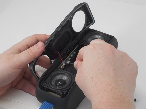

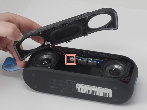

    2. Anker Soundcore Select 3 A3172 Battery Replacement: step 4, image 1 of 2 Anker Soundcore Select 3 A3172 Battery Replacement: step 4, image 2 of 2
      • Lift the speaker frame enough to access the microphone module JST connector attached to both the frame and a circuit board located between the drivers.
      • Use a pair of tweezers to firmly grip the sides of the connector and pull straight away from the socket on the board.
      • Hold the tweezers closer to the connector to get a better grip. If you're having trouble, try rocking the connector side-to-side to loosen it.
      • Avoid pulling on the wires directly.
      • Remove the frame.
