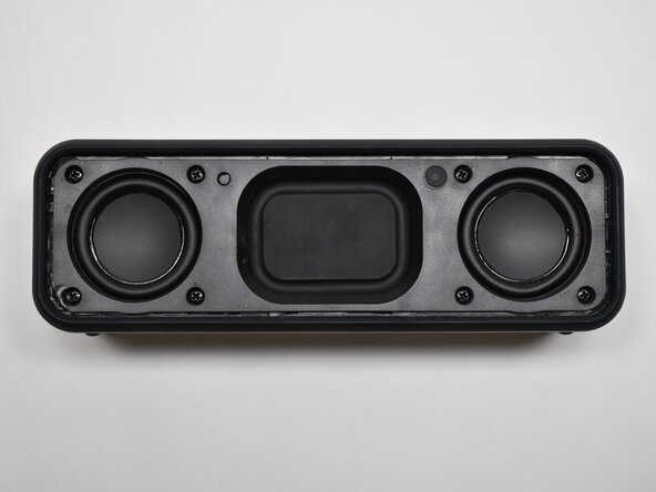

Anker Soundcore Select 2 A3125 Front Panel Replacement
    1. Anker Soundcore Select 2 A3125 Front Panel Replacement, Front Panel: step 1, image 1 of 2 Anker Soundcore Select 2 A3125 Front Panel Replacement, Front Panel: step 1, image 2 of 2
      • Insert a spudger between the front panel and the speaker housing.
      • Carefully work around the edges of the panel to release the clips securing it.
      • Gently remove the front panel from the main body of the device.
