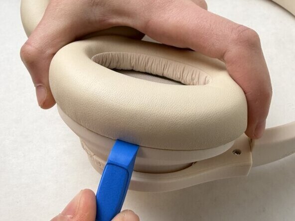

    2. Anker Soundcore Q20i Battery Replacement: step 2, image 1 of 1
      • Insert an opening tool into the groove where the left ear pad meets the left driver assembly.
      Ask FixBot
    3. Anker Soundcore Q20i Battery Replacement: step 3, image 1 of 2 Anker Soundcore Q20i Battery Replacement: step 3, image 2 of 2
      • Pry around the entire perimeter of the left ear pad until it fully releases.
