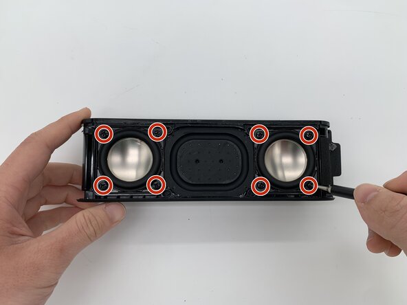

    1. Anker Soundcore Boost A3145 Driver Replacement, Drivers: step 10, image 1 of 1
      • Remove the eight 7 mm Phillips #1 screws that secure the two drivers.
