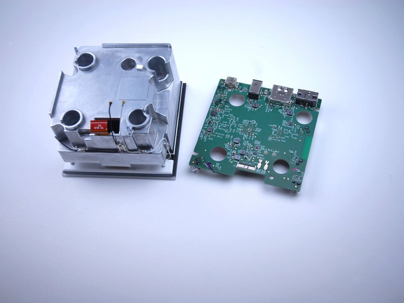

    1. Amazon Fire TV Cube Motherboard Replacement, Motherboard: step 5, image 1 of 2 Amazon Fire TV Cube Motherboard Replacement, Motherboard: step 5, image 2 of 2
      • Lift the black latch by gently prying up with the flat end of the Spudger.
      • Detach the copper tap by pulling it out.
      Ask FixBot
    2. Amazon Fire TV Cube Motherboard Replacement: step 6, image 1 of 2 Amazon Fire TV Cube Motherboard Replacement: step 6, image 2 of 2
      • Use the pointed end of the Spudger to carefully detach the black and white wires from the motherboard.
      • Make sure all three attachments (the copper tab and both wires) are fully disconnected before continuing.
      Ask FixBot
    3. Amazon Fire TV Cube Motherboard Replacement: step 7, image 1 of 2 Amazon Fire TV Cube Motherboard Replacement: step 7, image 2 of 2
      • Gently pry the motherboard up and off.
      Ask FixBot
