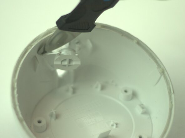

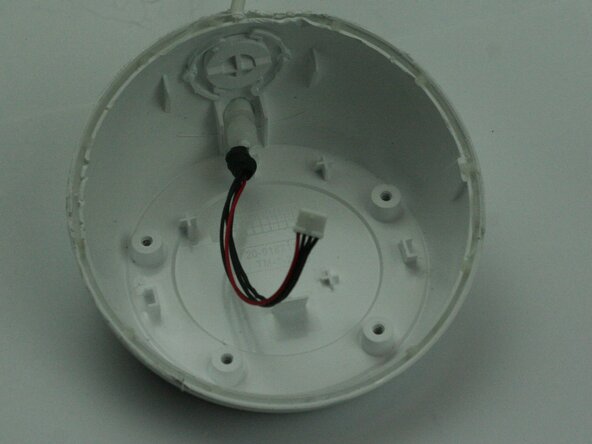

    5. Amazon Echo Glow Action Button Replacement: step 5, image 1 of 3 Amazon Echo Glow Action Button Replacement: step 5, image 2 of 3 Amazon Echo Glow Action Button Replacement: step 5, image 3 of 3
      • The bracket is removed from the device, you will then need to pull the red and black cables out from the device to ensure they won't be damaged.
      • There are two points that connect the button and the device together, you will need to cut through those two points with the metal spudger to remove the defective button from the device.
      Ask FixBot

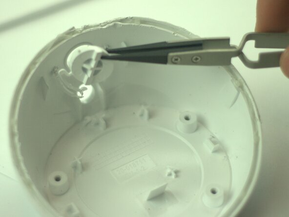

    6. Amazon Echo Glow Action Button Replacement: step 6, image 1 of 2 Amazon Echo Glow Action Button Replacement: step 6, image 2 of 2
      • Remove the defective action button with tweezers, once you have completed cutting through the two connectives points.
      • Now the button is removed apply adhesive glue to the new button at the same two points that they were previously connected to.
      • Allow for proper time for the adhesive glue to dry.
