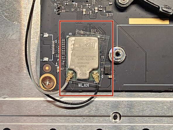

    1. Altyk L16 Laptop LCD Screen Replacement, Disconnect the Wi-Fi antennas: step 3, image 1 of 2 Altyk L16 Laptop LCD Screen Replacement, Disconnect the Wi-Fi antennas: step 3, image 2 of 2
      • Remove the clear tape securing the antennas.
      • Disconnect the antennas. The connectors on the board and the antennas themselves are very fragile, so proceed with caution.
      • Free the antennas up to the clutch hinge.
