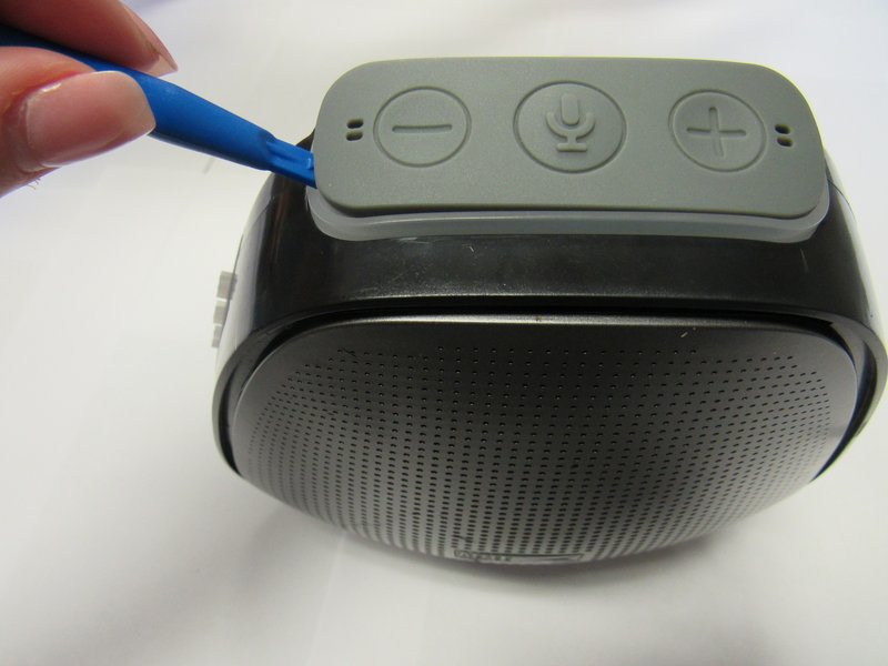

    1. Altec Lansing VersA Smart Volume Button Board Replacement, Volume Button Board: step 5, image 1 of 2 Altec Lansing VersA Smart Volume Button Board Replacement, Volume Button Board: step 5, image 2 of 2
      • Orient speaker so volume buttons are facing up.
      • Remove rubber button piece using the blue plastic opening tool.
