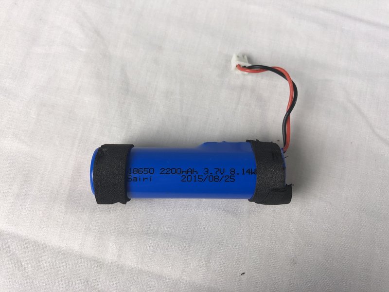

    1. Altec Lansing Mini Lifejacket 2 Battery Replacement, Battery: step 10, image 1 of 3 Altec Lansing Mini Lifejacket 2 Battery Replacement, Battery: step 10, image 2 of 3 Altec Lansing Mini Lifejacket 2 Battery Replacement, Battery: step 10, image 3 of 3
      • Disconnect the battery from the motherboard.
      • The battery is not secured within the case and can be removed after detaching its wiring from the circuit board.
      Ask FixBot

Where can you get the batteries? Altec Lansing doesn’t carry them.
alanp5 - Reply Share
Search for MCR18650 battery. They are available.
F Hickisch - Reply Share
Hickisch, I appreciate your guide on replacing this battery, but I beg to differ that replacement batteries are “available.” I keep getting sent batteries with 3-wire connectors instead of 2-wire. Plz send me a link, plz. Gracias.
rudy.ch.garcia - Reply Share
Sounds like you need to find another source instead of aliexpress or ebay. Digikey has them with the correct 2 wire connection. It's just a standard 18650 battery with the wires spot welded to the positive and negative terminals. Anything with a 3rd wire is likely meant as a charge sensing wire for a batter that has on board circuitry.
rchuncleskeleton - Reply Share
