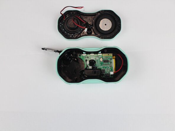

      • Starting with the seam between the grille and body, pry open the speaker using the metal spudger.
      Ask FixBot
    2. Altec Lansing Baby Boom XL Power Button Replacement: step 2, image 1 of 2 Altec Lansing Baby Boom XL Power Button Replacement: step 2, image 2 of 2
      • Remove the seven 11.09 mm screws using a Phillips screwdriver.
      • Place the loose screws onto the magnetic project mat.
      • Some units may include one shorter 9.25 mm screw. Keep track of its position for reassembly.
      Ask FixBot
    3. Altec Lansing Baby Boom XL Power Button Replacement: step 3, image 1 of 3 Altec Lansing Baby Boom XL Power Button Replacement: step 3, image 2 of 3 Altec Lansing Baby Boom XL Power Button Replacement: step 3, image 3 of 3
      • Insert a spudger between the front speaker components and the housing.
      • Gently separate the components.
      • Lift the components slightly to expose the internal wiring.
      Ask FixBot
    4. Altec Lansing Baby Boom XL Power Button Replacement: step 4, image 1 of 3 Altec Lansing Baby Boom XL Power Button Replacement: step 4, image 2 of 3 Altec Lansing Baby Boom XL Power Button Replacement: step 4, image 3 of 3
      • Disconnect the two wires attached to the speaker.
      • Remove the speaker from the housing.
      • Disconnect the wire connecting the battery to the motherboard.
      Ask FixBot

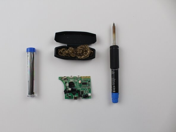

    8. Altec Lansing Baby Boom XL Power Button Replacement: step 8, image 1 of 3 Altec Lansing Baby Boom XL Power Button Replacement: step 8, image 2 of 3 Altec Lansing Baby Boom XL Power Button Replacement: step 8, image 3 of 3
      • Follow iFixit’s soldering guide for proper technique. How To Solder and Desolder Connections
      • Make sure to pay attention to how much solder you are feeding in; too little, and you won't get a good connection; too much, and you could short the pins.
