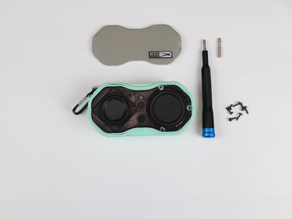

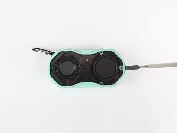

Altec Lansing Baby Boom XL Driver Replacement
  1. Altec Lansing Baby Boom XL Driver Replacement, Driver: step 1, image 1 of 3 Altec Lansing Baby Boom XL Driver Replacement, Driver: step 1, image 2 of 3 Altec Lansing Baby Boom XL Driver Replacement, Driver: step 1, image 3 of 3
    • Starting with the seam between the grille and body, pry open the speaker using the metal spudger.
    Ask FixBot
  2. Altec Lansing Baby Boom XL Driver Replacement: step 2, image 1 of 2 Altec Lansing Baby Boom XL Driver Replacement: step 2, image 2 of 2
    • Remove the seven 11.1 mm screws using a Phillips #2 screwdriver.
    • Place the loose screws onto the magnetic project mat.
    • Some units may include one shorter 9.25 mm screw. Keep track of its position for reassembly.
    Ask FixBot

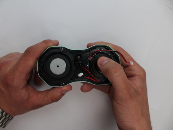

  3. Altec Lansing Baby Boom XL Driver Replacement: step 3, image 1 of 2 Altec Lansing Baby Boom XL Driver Replacement: step 3, image 2 of 2
    • Insert a spudger between the front speaker components and the housing.
    • Gently separate the components.
    • Lift the components slightly to expose the internal wiring.
    Ask FixBot
  4. Altec Lansing Baby Boom XL Driver Replacement: step 4, image 1 of 2 Altec Lansing Baby Boom XL Driver Replacement: step 4, image 2 of 2
    • Separate the top half of the device from the bottom half.
    • Press the speaker driver out of the housing.
    • Remove the speaker driver from the device.
