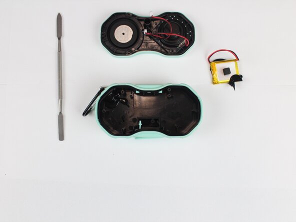

  7. Altec Lansing Baby Boom XL Battery Replacement: step 7, image 1 of 2 Altec Lansing Baby Boom XL Battery Replacement: step 7, image 2 of 2
    • Use angled tweezers to carefully grip the motherboard and lift it out of the device.
    • Use a metal spudger to carefully lift the battery out of the speaker.
    • Lift and remove the battery from the device.
