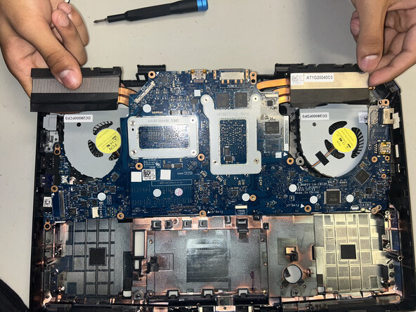

    8. Alienware 15 R2 Motherboard Replacement: step 8, image 1 of 1
      • Disconnect the cables.
      Ask FixBot
    9. Alienware 15 R2 Motherboard Replacement: step 9, image 1 of 2 Alienware 15 R2 Motherboard Replacement: step 9, image 2 of 2
      • Remove the motherboard using an iFixit opening tool anytime it becomes difficult to get out.
