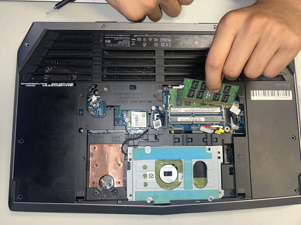

    2. Alienware 15 R2 Heatsink Replacement: step 2, image 1 of 1
      • Two clips secure each RAM module in place, one on each side. Using your fingers, spread the clips away from the RAM module.
      • Repeat for the second RAM module.

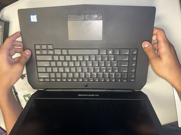

    3. Alienware 15 R2 Heatsink Replacement: step 3, image 1 of 2 Alienware 15 R2 Heatsink Replacement: step 3, image 2 of 2
      • Flip laptop around to keyboard side, then gently pry and lift the keyboard removing the keyboard.
