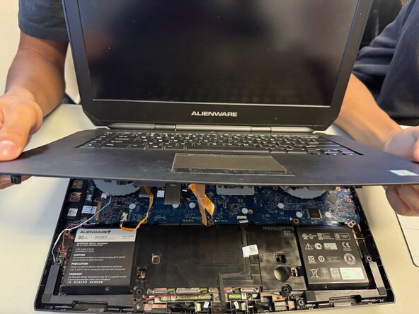

    4. Alienware 15 R2 CMOS Battery Replacement: step 4, image 1 of 1
      • Use a Phillips #0 screwdriver to remove the six 6 mm screws from the back casing.
      • You can stick your finger in the hole next to the SSD slot for more space to separate the back casing from the keyboard.

    5. Alienware 15 R2 CMOS Battery Replacement: step 5, image 1 of 1
      • Lift the keyboard off of the frame of the laptop.

    6. Alienware 15 R2 CMOS Battery Replacement: step 6, image 1 of 1
      • Using your fingers, disconnect the TRON light cable from the motherboard.
