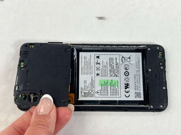

    3. Alcatel Lively Jitterbug Smart3 Rear-facing Camera Replacement: step 3, image 1 of 3 Alcatel Lively Jitterbug Smart3 Rear-facing Camera Replacement: step 3, image 2 of 3 Alcatel Lively Jitterbug Smart3 Rear-facing Camera Replacement: step 3, image 3 of 3
      • Use the pry tool of fingernail to gently separate the plastic frame from the phone.
      • Slowly work around the edges, being careful of the fragile clips.

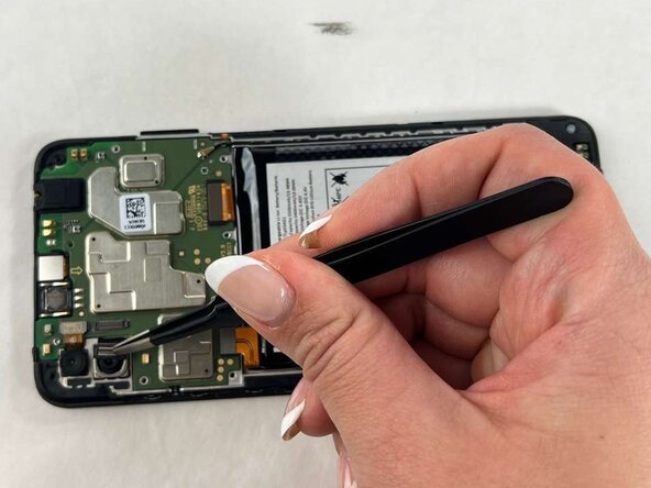

    4. Alcatel Lively Jitterbug Smart3 Rear-facing Camera Replacement: step 4, image 1 of 3 Alcatel Lively Jitterbug Smart3 Rear-facing Camera Replacement: step 4, image 2 of 3 Alcatel Lively Jitterbug Smart3 Rear-facing Camera Replacement: step 4, image 3 of 3
      • Detach the camera module's cable connector from the motherboard.
      • Do not force the wire, as it is fragile
      • Carefully lift the camera out of its slot.
