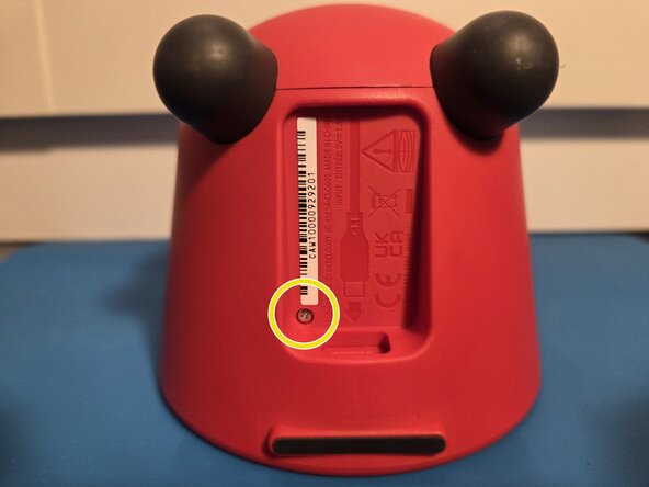

If your alarmo is no longer saving date and time when it loses power, it's probably the CMOS battery. This guide will instruct you on how to swap it.
    1. Alarmo CMOS Battery Replacement, Removing the outer screw.: step 1, image 1 of 1
      • Flip your Alarmo so you can see the USB-C port.
      • Use a tri-point Y00 driver to remove the silver screw just below the S/N sticker.
