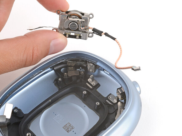

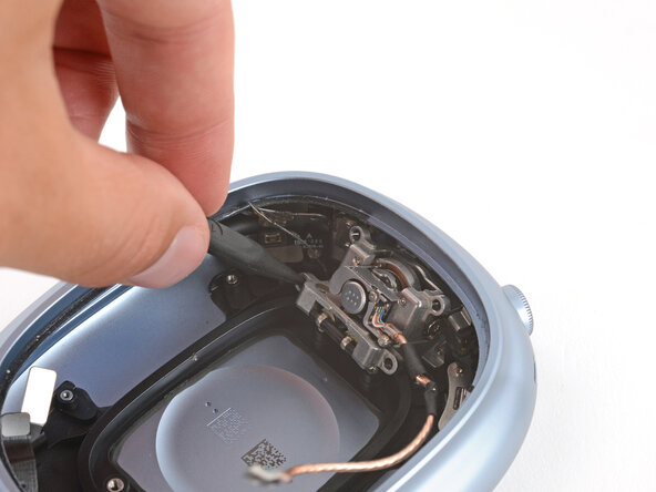

  30. AirPods Max Right Headband Hinge Replacement, Disconnect the hinge: step 30, image 1 of 2 AirPods Max Right Headband Hinge Replacement, Disconnect the hinge: step 30, image 2 of 2
    • Use the point of a spudger to pry up and disconnect the hinge press connector (the smaller one, whose cable runs back towards the hinge).
  31. AirPods Max Right Headband Hinge Replacement, Unclip the hinge cable: step 31, image 1 of 2 AirPods Max Right Headband Hinge Replacement, Unclip the hinge cable: step 31, image 2 of 2
    • Use your fingers to gently pull the copper hinge cable (in plastic tubing) out of its clip.
  32. AirPods Max Right Headband Hinge Replacement, Remove the hinge screws: step 32, image 1 of 2 AirPods Max Right Headband Hinge Replacement, Remove the hinge screws: step 32, image 2 of 2
    • Use a Torx Plus 5IP screwdriver to remove the four 5.3 mm‑long screws securing the hinge.
    • You may need to use a flexible extension for these screws.

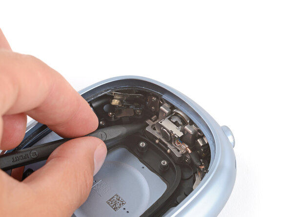

  33. AirPods Max Right Headband Hinge Replacement, Remove the hinge: step 33, image 1 of 3 AirPods Max Right Headband Hinge Replacement, Remove the hinge: step 33, image 2 of 3 AirPods Max Right Headband Hinge Replacement, Remove the hinge: step 33, image 3 of 3
    • Slide the point of a spudger into one of the hinge's lower screw holes.
    • Use the spudger to rotate the bottom edge of the hinge upwards to free the hinge.
    • This is tricky, as the hinge fits tightly in its recess. If you're having trouble, gently wiggle the hinge while rotating it.
    • Remove the hinge.

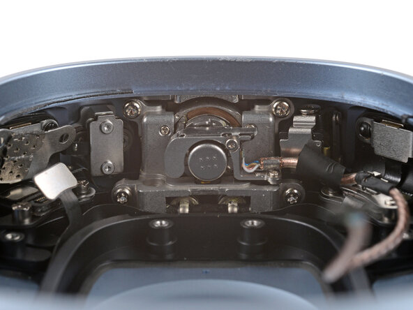

  34. AirPods Max Right Headband Hinge Replacement, Disassembly complete: step 34, image 1 of 1
    • Congratulations on completing disassembly! The remaining steps will show how to reassemble your AirPods Max.

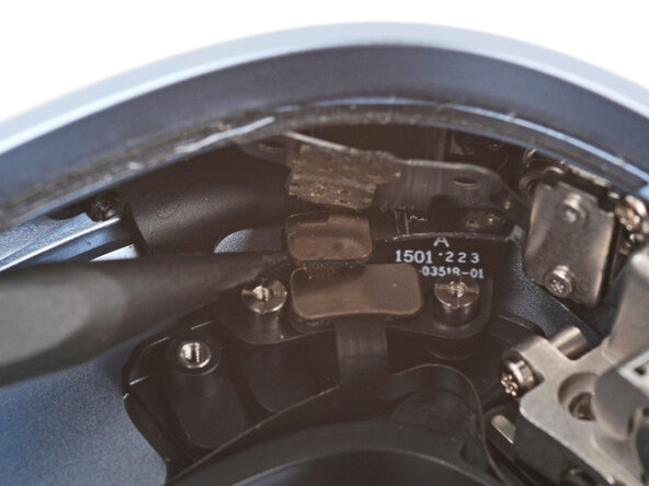

  35. AirPods Max Right Headband Hinge Replacement, Hinge cable information: step 35, image 1 of 3 AirPods Max Right Headband Hinge Replacement, Hinge cable information: step 35, image 2 of 3 AirPods Max Right Headband Hinge Replacement, Hinge cable information: step 35, image 3 of 3
    • Before putting the hinge back into place, note the following:
    • The black ribbon cable coming out of the left side of the hinge needs to be routed behind the lower screw post. Otherwise, it will likely tear. You may need to use tweezers to do this while you put the hinge in place.
    • There's a long ribbon cable that needs to run in front of the hinge. Make sure it doesn't get stuck under the hinge, or it may get damaged.

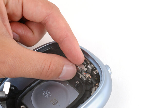

  36. AirPods Max Right Headband Hinge Replacement, Put the hinge into place: step 36, image 1 of 3 AirPods Max Right Headband Hinge Replacement, Put the hinge into place: step 36, image 2 of 3 AirPods Max Right Headband Hinge Replacement, Put the hinge into place: step 36, image 3 of 3
    • The hinge needs to be placed so the copper cable goes near the Digital Crown and the black ribbon cable goes towards the noise control button.
    • Insert the hinge into its recess at a slight downward angle and then rotate it into place, making sure all four screw holes line up.
    • Before moving on, go back to the previous step and make sure the cable are in the proper locations.
  37. AirPods Max Right Headband Hinge Replacement, Install the hinge screws: step 37, image 1 of 2 AirPods Max Right Headband Hinge Replacement, Install the hinge screws: step 37, image 2 of 2
    • Use a Torx Plus 5IP screwdriver to install the four 5.3 mm‑long screws securing the hinge.
  38. AirPods Max Right Headband Hinge Replacement, Clip the hinge wire: step 38, image 1 of 2 AirPods Max Right Headband Hinge Replacement, Clip the hinge wire: step 38, image 2 of 2
    • Use a spudger to gently push the copper hinge cable into its clip.
    • If you're having trouble, don't force the cable into the clip. Reposition it slightly and try again.
  39. AirPods Max Right Headband Hinge Replacement, Reconnect the hinge: step 39, image 1 of 1
    • While holding the hinge's ribbon cable in place with tweezers, use a spudger to reconnect the press connector.
  40. AirPods Max Right Headband Hinge Replacement: step 40, image 1 of 1
    • Use your finger to bend the connector cover back into place.
