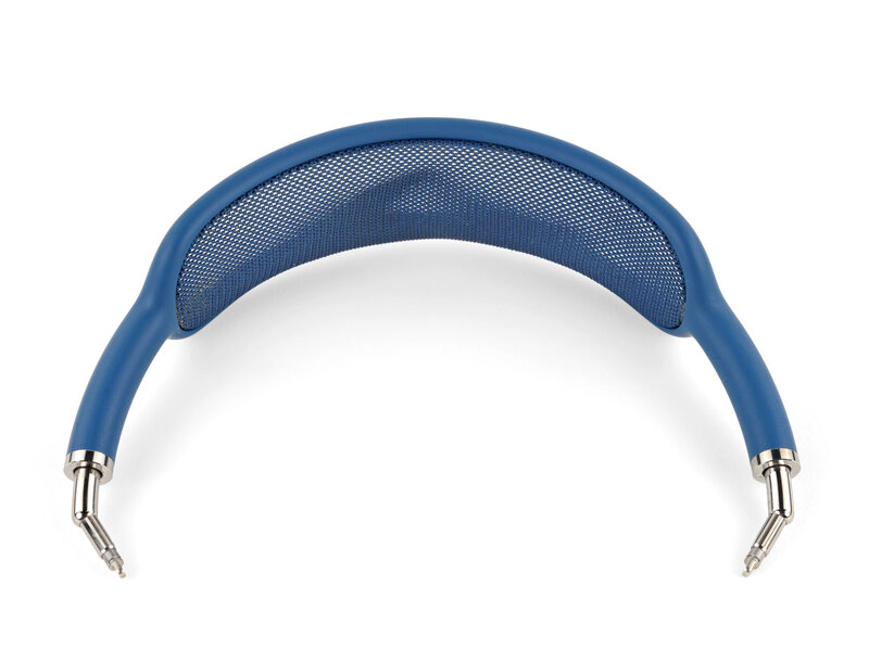

Follow this guide to replace or upgrade the headband on your AirPods Max.

    1. AirPods Max Headband Replacement, You're left with the headband: step 5, image 1 of 1
      • You're left with the headband for replacement.
