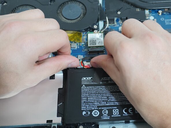

    3. Acer Nitro 5 AN515-54 (Intel) RAM Replacement: step 3, image 1 of 2 Acer Nitro 5 AN515-54 (Intel) RAM Replacement: step 3, image 2 of 2
      • Use the wide end of a spudger to carefully push on the battery connector tab to slide it out of its socket on the motherboard.
      • It may take a lot of force to disconnect the cable. Go slowly, and don't pull on the cables.

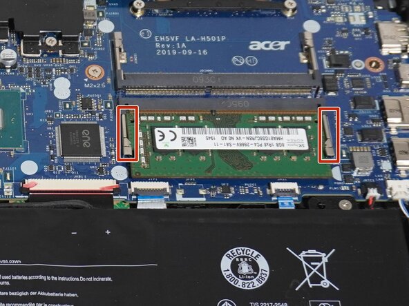

    4. Acer Nitro 5 AN515-54 (Intel) RAM Replacement: step 4, image 1 of 3 Acer Nitro 5 AN515-54 (Intel) RAM Replacement: step 4, image 2 of 3 Acer Nitro 5 AN515-54 (Intel) RAM Replacement: step 4, image 3 of 3
      • Gently push the silver retention clips away from the RAM stick to release it.
      • The RAM stick should pop up at an angle.
      • Grab it by the edges and carefully slide it out of the slot.

    5. Acer Nitro 5 AN515-54 (Intel) RAM Replacement: step 5, image 1 of 2 Acer Nitro 5 AN515-54 (Intel) RAM Replacement: step 5, image 2 of 2
      • Match the notch on the new RAM module to the ridge in the slot, then slide the RAM into the slot at a 45° angle.
      • Do not force the RAM. It should fit smoothly when properly aligned.
      • Press it down until both side clips snap and lock the RAM into place.

    6. Acer Nitro 5 AN515-54 (Intel) RAM Replacement: step 6, image 1 of 1
      • Align the battery connector with the socket on the motherboard and gently slide it into place until it is fully seated.
      • Make sure the battery connector is secure and does not feel loose.
