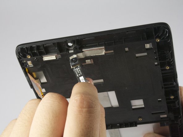

    1. Acer Iconia A110 Front Facing Camera Replacement, Front Facing Camera: step 9, image 1 of 3 Acer Iconia A110 Front Facing Camera Replacement, Front Facing Camera: step 9, image 2 of 3 Acer Iconia A110 Front Facing Camera Replacement, Front Facing Camera: step 9, image 3 of 3
      • Carefully gripping the top of the camera connection cord, slowly pull down to remove the sticky tape from the tablet.
