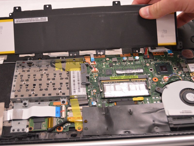

    4. ASUS Vivobook S500CA Battery Replacement: step 4, image 1 of 1
      • Remove 9 (.5 cm) phillips screws around the edge of the battery.
      Ask FixBot
    5. ASUS Vivobook S500CA Battery Replacement: step 5, image 1 of 1
      • Lift up the battery to reveal the battery terminal.
      Ask FixBot
    6. ASUS Vivobook S500CA Battery Replacement: step 6, image 1 of 1
      • Unclip the battery terminal by prying straight up on the sides of the connector to release the clip.
      Ask FixBot
