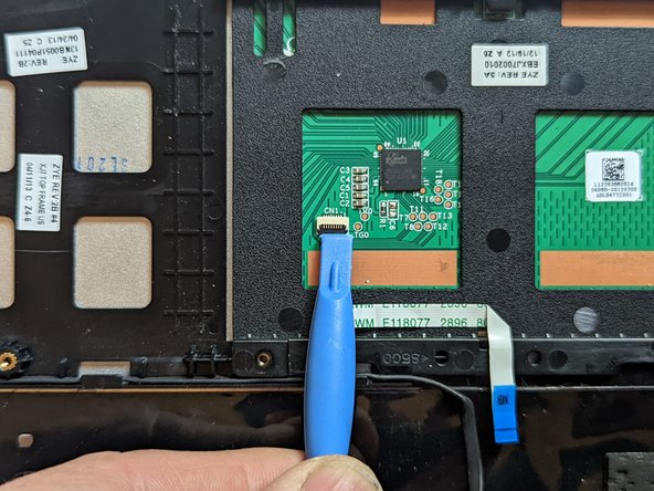

    1. ASUS VivoBook S400C Trackpad Replacement, Trackpad: step 36, image 1 of 3 ASUS VivoBook S400C Trackpad Replacement, Trackpad: step 36, image 2 of 3 ASUS VivoBook S400C Trackpad Replacement, Trackpad: step 36, image 3 of 3
      • Flip the retaining latch on the trackpad ribbon cable connector up with a spudger.
      Ask FixBot
    2. ASUS VivoBook S400C Trackpad Replacement: step 37, image 1 of 2 ASUS VivoBook S400C Trackpad Replacement: step 37, image 2 of 2
      Tool used on this step:
      Buy
      • Grasp the blue tab with fine tip tweezers and pull the cable straight out from the connector.
      • Gently peel the trackpad ribbon cable off the trackpad.
      Ask FixBot
    3. ASUS VivoBook S400C Trackpad Replacement, Remove the Trackpad: step 38, image 1 of 2 ASUS VivoBook S400C Trackpad Replacement, Remove the Trackpad: step 38, image 2 of 2
      • Lift the side of the trackpad farthest from the side of the case and slide it away from the edge to remove it.
