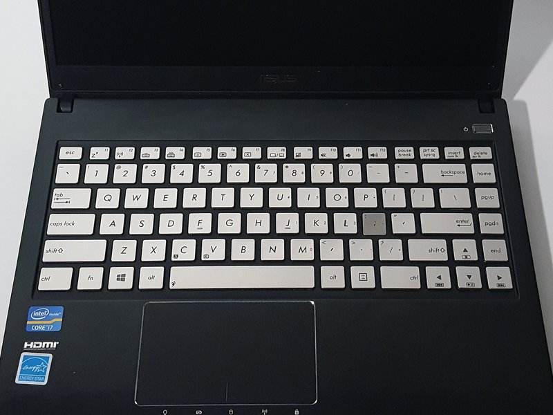

Keys can be dirty and unresponsive. Use this guide to clean under or replace keys.
Tools
    1. ASUS Q400A-BHI7N03 Key Replacement, Key: step 1, image 1 of 1
      • To remove a key, insert the opening tool in the small gap at the top right corner of the key.
      • Pry off the key by pulling the tool up until the key pops off.
      • If the key is still connected at the bottom, wiggle the key from side to side until it comes off.

    3. ASUS Q400A-BHI7N03 Key Replacement: step 3, image 1 of 1
      • To put the key back in, line it up with the area it came from and push it back in. There will be an audible click when it is correctly inserted.

Some keys seem to also have a metal bracket under them that need to be strung in when re-inserting the key. Maybe add some instruction for that.
