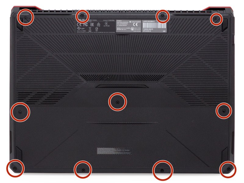

    1. ASUS FX505 DU AL49 GPU FAN Replacement, Remove the back cover of the laptop: step 1, image 1 of 1
      • Unscrew the screws and with a plastic prying tool remove the cover carefully

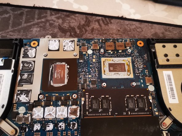

    8. ASUS FX505 DU AL49 GPU FAN Replacement, Cleaning the GPU and CPU: step 8, image 1 of 2 ASUS FX505 DU AL49 GPU FAN Replacement, Cleaning the GPU and CPU: step 8, image 2 of 2
      • Remove the old thermal paste carefully with aceton and a tissue. If you dont have aceton, you can use just a tissue.

    9. ASUS FX505 DU AL49 GPU FAN Replacement, Apply the new paste: step 9, image 1 of 1
      • Be careful apply only so many which is necessary!!! In my opinion always check your new paste for conductivity and choose the ones with no eletrical conductivity because if you accidentaly spary on the motherboard you are still safe!!!!
