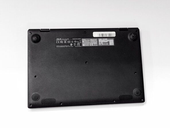

    • Place the laptop upside down with the touchpad pointing toward you.
    • Use a JIS #00 screwdriver to remove the ten 7.0 mm screws from the bottom of the laptop.

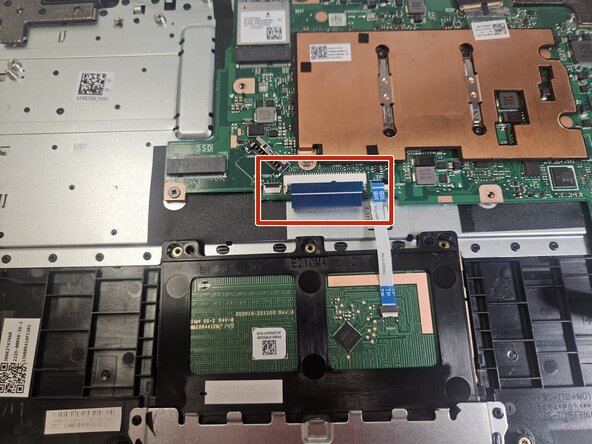

    • Locate the touchpad at the front of the device.
    • Disconnect the ribbon cable and peel back any adhesive securing it.
