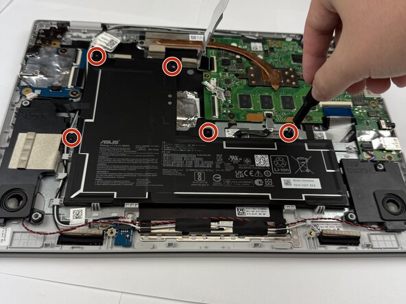

    3. ASUS Chromebook CX1400CN Touchpad Replacement: step 3, image 1 of 3 ASUS Chromebook CX1400CN Touchpad Replacement: step 3, image 2 of 3 ASUS Chromebook CX1400CN Touchpad Replacement: step 3, image 3 of 3
      • Be careful when removing the connections as to not break them.
      • Detach the connectors that are in the way of lifting the battery out.
      • Remove the power delivery-to-motherboard connection.
      • Remove the battery-to-motherboard connection.
      • Remove the five 3mm screws securing the battery using a Phillips #1 screwdriver.

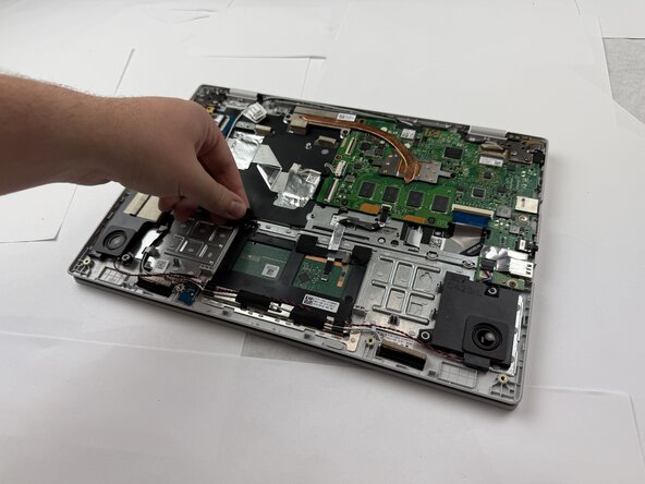

    1. ASUS Chromebook CX1400CN Touchpad Replacement, Touchpad: step 5, image 1 of 2 ASUS Chromebook CX1400CN Touchpad Replacement, Touchpad: step 5, image 2 of 2
      • At the back of the touchpad, remove the stickers covering the screws.
      • Secure the stickers in an area that they will not stick to.
      Ask FixBot

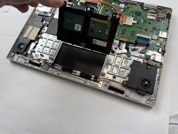

    2. ASUS Chromebook CX1400CN Touchpad Replacement: step 6, image 1 of 2 ASUS Chromebook CX1400CN Touchpad Replacement: step 6, image 2 of 2
      • On the right side of the back of the touchpad, carefully detach the foil on the connector to disable its sensors.
      Ask FixBot
    3. ASUS Chromebook CX1400CN Touchpad Replacement: step 7, image 1 of 3 ASUS Chromebook CX1400CN Touchpad Replacement: step 7, image 2 of 3 ASUS Chromebook CX1400CN Touchpad Replacement: step 7, image 3 of 3
      • Remove the 3mm screws using a Phillips #1 screwdriver.
      • Remove the touchpad from the laptop.
