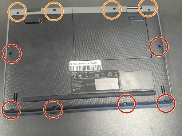

      • Close the lid and set the laptop with down the bottom facing up.
      • Use a Phillips #0 screwdriver to remove the following screws:
      • Six 6 mm-long
      • Four 8 mm-long
      • Lift and remove the panel.

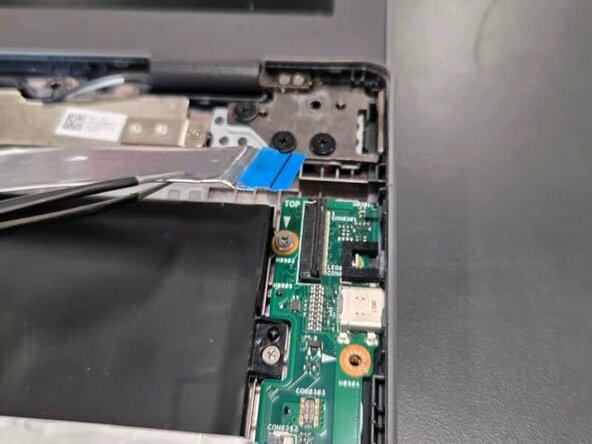

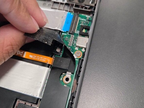

    13. ASUS Chromebook C204MA Battery Replacement: step 13, image 1 of 2 ASUS Chromebook C204MA Battery Replacement: step 13, image 2 of 2
      • On the I/O board on the right half of the laptop, lift the black mylar film and unscrew the single 4 mm-long Phillips #0 screw.
      • Lift off the orange cable and black mylar film and set aside.
      Ask FixBot
    14. ASUS Chromebook C204MA Battery Replacement: step 14, image 1 of 3 ASUS Chromebook C204MA Battery Replacement: step 14, image 2 of 3 ASUS Chromebook C204MA Battery Replacement: step 14, image 3 of 3
      • Lift up the locking flap securing the I/O board ribbon cable and disconnect the cable.
      Ask FixBot
