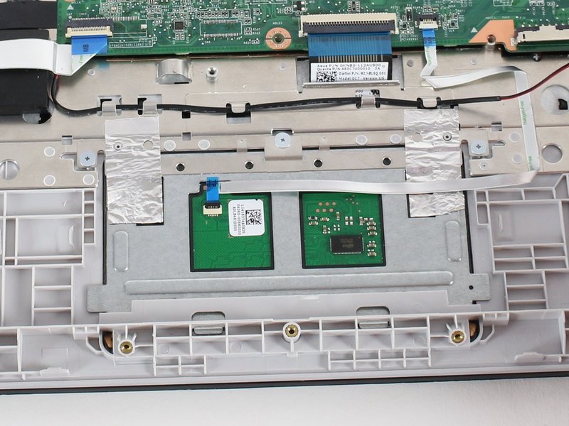

    1. ASUS Chromebook C200MA DS01 Touchpad Replacement, Touchpad: step 7, image 1 of 1
      • Locate the touchpad.
      • Locate the touch pad cable connector.
      Ask FixBot
    2. ASUS Chromebook C200MA DS01 Touchpad Replacement: step 8, image 1 of 3 ASUS Chromebook C200MA DS01 Touchpad Replacement: step 8, image 2 of 3 ASUS Chromebook C200MA DS01 Touchpad Replacement: step 8, image 3 of 3
      • Disconnect the touch pad ZIF(zero insertion force) connector.
      • Flip the flap up using a spudger or your fingers.
      • Pull gently on the ribbon cable to disconnect.
      Ask FixBot
    3. ASUS Chromebook C200MA DS01 Touchpad Replacement: step 9, image 1 of 1
      • Gently remove the adhesive on the touch pad ribbon cable.
      Ask FixBot
    4. ASUS Chromebook C200MA DS01 Touchpad Replacement: step 10, image 1 of 3 ASUS Chromebook C200MA DS01 Touchpad Replacement: step 10, image 2 of 3 ASUS Chromebook C200MA DS01 Touchpad Replacement: step 10, image 3 of 3
      • Gently remove the metallic tape from the touch pad only.
      • Try not to tear the tape, it can be re-used during reassembly.
      Ask FixBot
    5. ASUS Chromebook C200MA DS01 Touchpad Replacement: step 11, image 1 of 1
      • Remove the three 1.8 mm Phillips #00 screws.
      Ask FixBot
    6. ASUS Chromebook C200MA DS01 Touchpad Replacement: step 12, image 1 of 2 ASUS Chromebook C200MA DS01 Touchpad Replacement: step 12, image 2 of 2
      • Lift the far edge of the touch pad to remove it.
      Ask FixBot
