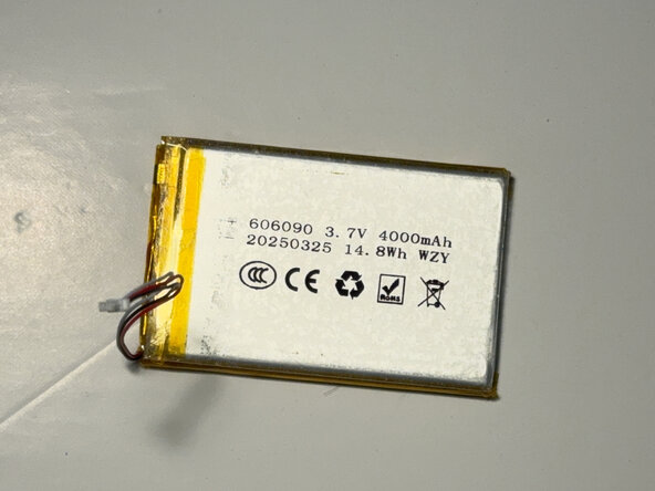

  5. AJAZZ AK820 Pro Battery Replacement: step 5, image 1 of 3 AJAZZ AK820 Pro Battery Replacement: step 5, image 2 of 3 AJAZZ AK820 Pro Battery Replacement: step 5, image 3 of 3
    • Use a pair of tweezers to gently pull out the cable connector from the socket on the board, then follow it to locate the battery.
    • If the tweezers aren't working, use the point of a spudger to push on alternating sides of the battery connector to "walk" it out of its socket.
    • Don't pull it out by the cables, as this may damage the device.
    • The battery is right below the foam and rubber padding.
    • Remove the old battery.
