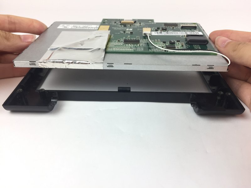

    1. ACN Iris WG4K Video Screen Replacement, Video Screen Ribbon Cable: step 17, image 1 of 1
      • Note that the video screen is no longer attached to the top case, place in on a flat surface.
      • Gently lift of the silver casing.
      Ask FixBot
    2. ACN Iris WG4K Video Screen Replacement: step 18, image 1 of 3 ACN Iris WG4K Video Screen Replacement: step 18, image 2 of 3 ACN Iris WG4K Video Screen Replacement: step 18, image 3 of 3
      • The two ribbon connectors are indicated by the red rectangles.
      • Disconnect the two ribbon cables from their insulation-displacement connectors by flipping up the black plastic clip.
      • Gently pull out the ribbon cables. Gently pull out the ribbon cables.
      Ask FixBot
    1. ACN Iris WG4K Video Screen Replacement, Video Screen: step 19, image 1 of 1
      • Gently lift the video screen out of its case.
      Ask FixBot
