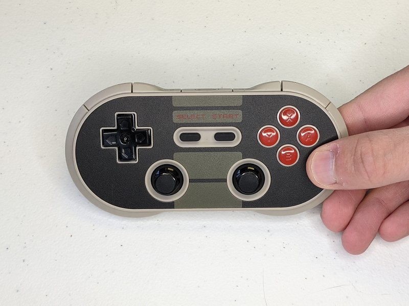

Use this guide to take the 8BitDo NES30 Pro Gamepad apart and replace its face buttons.
You may want to replace old buttons with a new set as they wear out over time, or maybe you just want to give your controller’s existing buttons a new paint job.
This guide may also be useful if the L and R buttons on the shoulders of the controllers become jammed, meaning they become permanently pressed down. Although the shoulder buttons aren’t removable, you can follow the disassembly process of this guide through Step 3 to access the shoulder buttons and pop them back to their original position.
    1. 8BitDo NES30 Pro Gamepad Button Replacement, Button: step 1, image 1 of 2 8BitDo NES30 Pro Gamepad Button Replacement, Button: step 1, image 2 of 2
      • Hold the controller with its back facing towards you.
      • Insert an opening pick between the L1 or R1 button and the backplate, and pry the backplate off of the controller.
