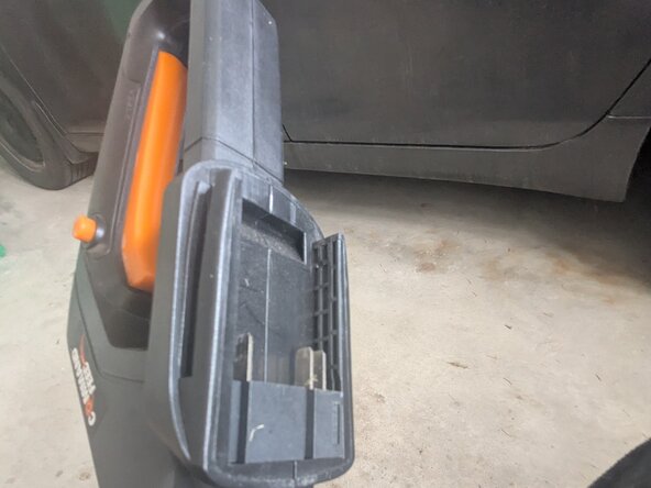

    • Press and hold down the large orange button on the top of the battery.
    • While holding the orange button, firmly slide the battery down the handguard of the trimmer to disconnect it.
    • Removing the battery ensures the device cannot unintentionally activate mid repair, skipping this step may result in serious injury.
