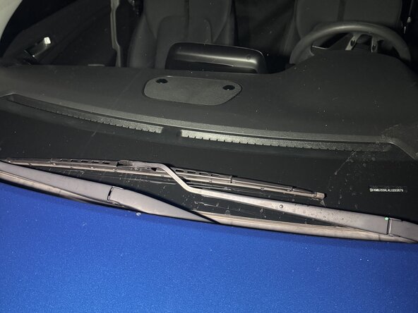

    • Lift the arms of the windshield wipers.

  2. 2020 Hyundai Tuscon Windshield Wiper Replacement: step 2, image 1 of 3 2020 Hyundai Tuscon Windshield Wiper Replacement: step 2, image 2 of 3 2020 Hyundai Tuscon Windshield Wiper Replacement: step 2, image 3 of 3
    • Turn the blade perpendicular to the J-hook and push the blade down toward the base of the arm to release it.
