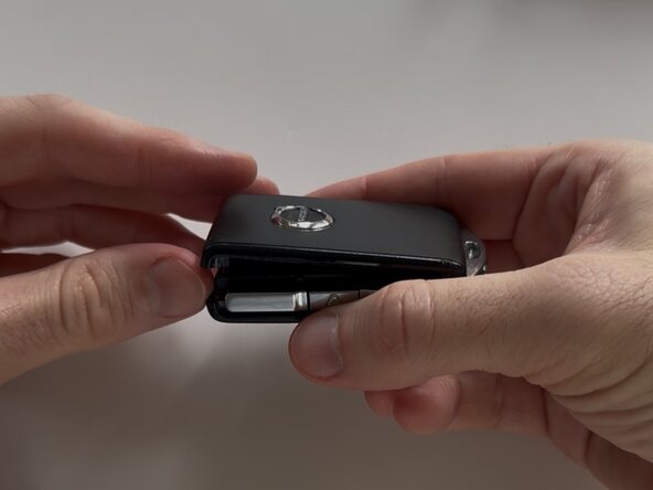

    • Place the key with the Volvo logo facing up and the keyring loop facing you.
    • Slide the small latch on the left to the side, and lift the cover off.

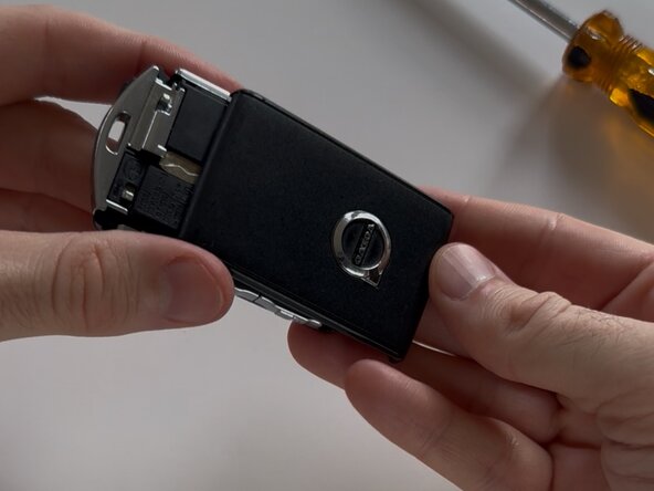

    • Slide the second latch under the front cover, and lift the rear cover off.
    • This will reveal an internal, physical key on one side and a round battery cover on the other side.

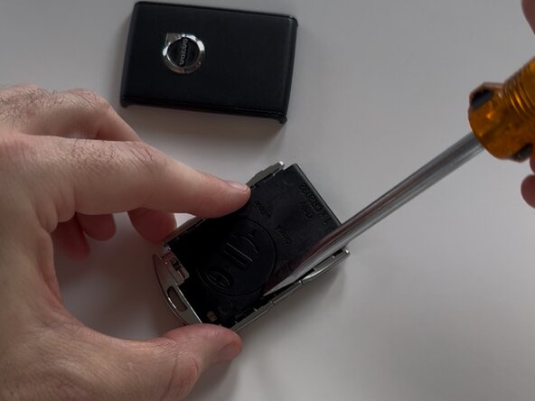

    • Use a flathead screwdriver to twist the battery cover counterclockwise into the Open position.
    • Lift the battery cover to remove it.

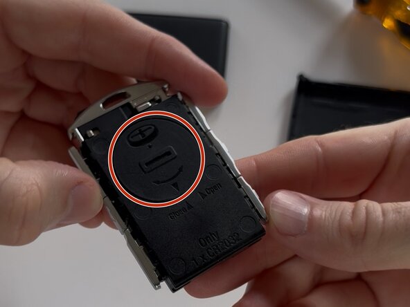

    • Remove the battery.
    • Insert the replacement with the + side facing out.
    • Make sure to press the new battery down until it catches.
    • It is recommended to only minimally touch the battery directly with your fingers.

    • Reposition the battery cover over the battery and use the screwdriver to turn clockwise to the Close position.
