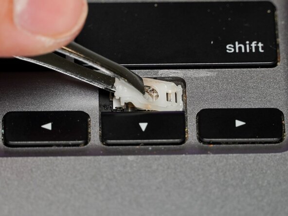

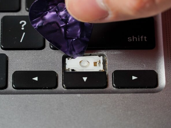

    3. 2019 MacBook Air Up Arrow Key (3rd Gen Butterfly Keyboard) Replacement: step 3, image 1 of 3 2019 MacBook Air Up Arrow Key (3rd Gen Butterfly Keyboard) Replacement: step 3, image 2 of 3 2019 MacBook Air Up Arrow Key (3rd Gen Butterfly Keyboard) Replacement: step 3, image 3 of 3
      • Use an opening pick to gently pry off the white key clip from left to right.

    4. 2019 MacBook Air Up Arrow Key (3rd Gen Butterfly Keyboard) Replacement: step 4, image 1 of 2 2019 MacBook Air Up Arrow Key (3rd Gen Butterfly Keyboard) Replacement: step 4, image 2 of 2
      • Brush away any debris/dust within the key.
      • Be careful with the rubber sensor; it is very delicate and can come off.
