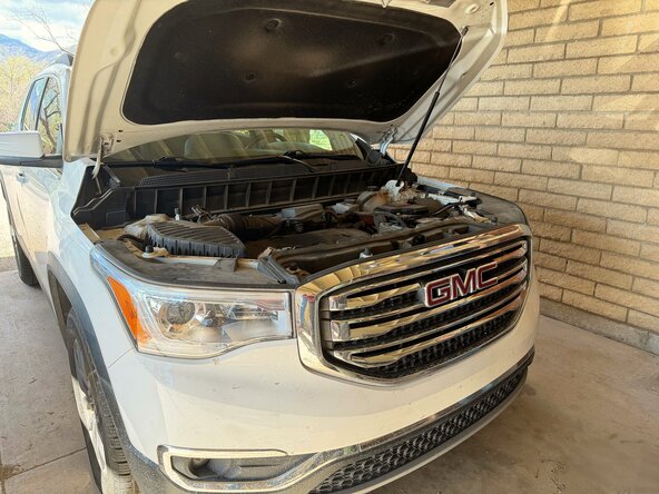

      • Access the bulb housing by lifting the hood of the car.
      • The bulb is behind the headlamp in the interior of the engine compartment.

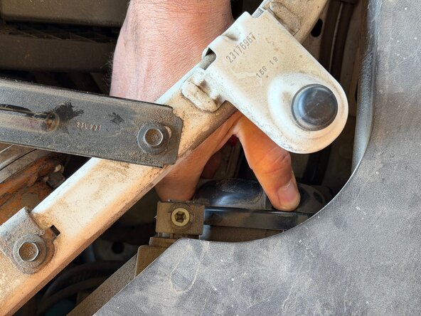

      • Reach into the opening for the domed cap.
      Ask FixBot

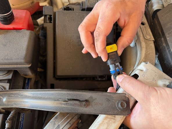

      • Detach the bulb from the socket cord.
      • Release the locking clip from the socket cord and the bulb.
      • Gently pull the socket cord from the bulb.
