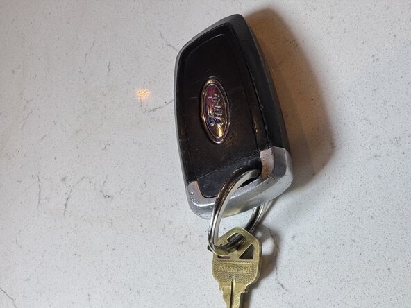

  1. 2019 Ford Fusion Key Fob Battery Replacement, Key fob battery: step 1, image 1 of 3 2019 Ford Fusion Key Fob Battery Replacement, Key fob battery: step 1, image 2 of 3 2019 Ford Fusion Key Fob Battery Replacement, Key fob battery: step 1, image 3 of 3
    • Insert a small spudger or opening tool into the seam near the keyring.
    • Gently twist the spudger to separate the black cover from the key fob.

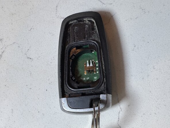

  2. 2019 Ford Fusion Key Fob Battery Replacement: step 2, image 1 of 3 2019 Ford Fusion Key Fob Battery Replacement: step 2, image 2 of 3 2019 Ford Fusion Key Fob Battery Replacement: step 2, image 3 of 3
    • Use your fingers or the end of a spudger to remove the old battery.
    • Note the battery’s orientation (+/–) before removing it to ensure the new battery is installed correctly.

  3. 2019 Ford Fusion Key Fob Battery Replacement: step 3, image 1 of 3 2019 Ford Fusion Key Fob Battery Replacement: step 3, image 2 of 3 2019 Ford Fusion Key Fob Battery Replacement: step 3, image 3 of 3
    • Insert the new CR2450 lithium battery into the slot.
    • Note the orientation(+/-) of the battery slot.
    • Press it down with your fingers.

  4. 2019 Ford Fusion Key Fob Battery Replacement: step 4, image 1 of 2 2019 Ford Fusion Key Fob Battery Replacement: step 4, image 2 of 2
    • Align the cover with the fob and press them together firmly until they snap back into place.
    • Reinsert the mechanical key if it was removed.
