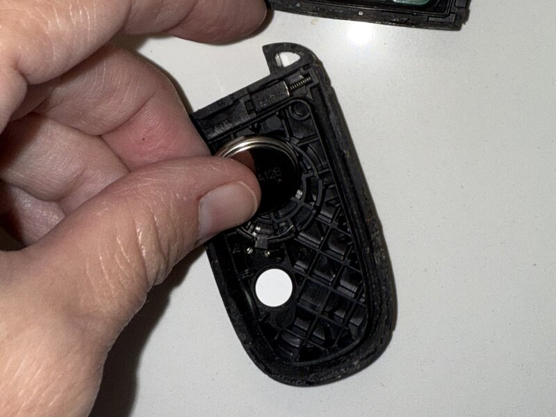

    4. 2018 Jeep Compass Key Fob Battery Replacement: step 4, image 1 of 1
      • Replace the new battery in the battery holder.
      • Make sure that the battery is inserted correctly with positive(+) and negative(-) terminals corresponding with the symbols on the device, or the key fob will not work.
      Ask FixBot
