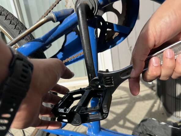

  4. 2018 Felt Bixby Pedal Replacement: step 4, image 1 of 1
    • Use the crescent wrench to loosen the spindle counter-clockwise.
    • Remove the pedal.

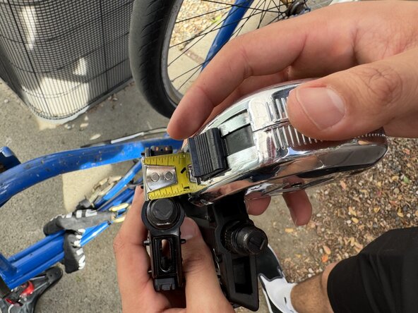

  5. 2018 Felt Bixby Pedal Replacement: step 5, image 1 of 2 2018 Felt Bixby Pedal Replacement: step 5, image 2 of 2
    • Using a measuring tape, take the diameter of the crank arm thread opening to find the proper fitting.
