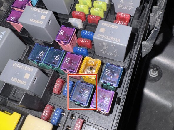

    • Check for symptoms: fan not spinning at all speeds, engine overheating (especially in traffic). Open the under-hood fuse box (near the battery). Find the cooling fan fuse using the lid diagram or owner's manual.
    • Red: Cooling Fan Fuse
    • NOTE: Make sure the vehicle is off to prevent damage to any electrical components
    • NOTE: A blown fuse can indicate a deeper electrical problem. If a replacement fuse blows right away, stop and consult a mechanic before continuing.

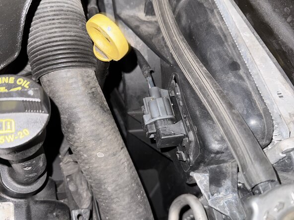

    • Look into the engine bay and locate the radiator fan assembly. The radiator fan resistor is mounted on the LEFT side of the fan shroud (the black plastic housing surrounding the fan). It is a small rectangular component with two screws and a wiring harness connector attached.
    • Let the engine cool for at least 30 minutes before touching anything in the engine bay.
    • Pink: Radiator Fan Resistor Location

    • Locate the wiring harness connector on the resistor. Press down on the locking tab (the small plastic tab on the side of the connector) with your thumb while gripping the connector body firmly. Pull straight out — do not pull by the wires. The connector should release smoothly.
    • Blue: Wiring Harness Connector
    • WARNING: Always grip the connector body, not the wires. Pulling by the wires can snap the locking tab or damage the harness.
    • NOTE: If it does not release, make sure the locking tab is fully pressed before pulling.

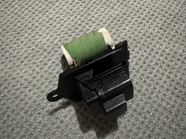

    • Using your 8mm socket and ratchet with extension, remove the two mounting screws holding the resistor to the fan shroud. Tip: If the screws are rusted, apply a small amount of penetrating oil (WD-40 or PB Blaster) and wait 10 minutes before removal to avoid stripping.
    • Blue: Mounting Clip
    • Yellow: Radiator Fan Resistor
    • Pink: Engine
    Ask FixBot
    • Align the new resistor with the opening in the fan shroud and slide it straight in. Do not angle or force it. Once flush against the housing, thread the two 8mm screws in by hand, then tighten snug with the socket (approx. 20 in-lbs).
    • WARNING: Do NOT overtighten this can crack the plastic mounting flange.
