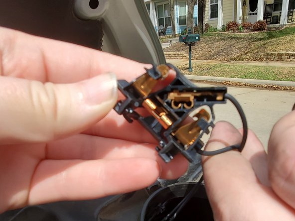

  7. 2016 Ford Fiesta S High Beam Replacement: step 7, image 1 of 2 2016 Ford Fiesta S High Beam Replacement: step 7, image 2 of 2
    • Turn the bulb and the electrical connector counterclockwise and remove them.
    Ask FixBot
  8. 2016 Ford Fiesta S High Beam Replacement: step 8, image 1 of 2 2016 Ford Fiesta S High Beam Replacement: step 8, image 2 of 2
    • Make sure you do not touch the glass surface of the bulb with your bare hands; if the oil from your hands touches the glass surface, it may cause the bulb to heat up and burn out.
    • Clean the bulb with rubbing alcohol to remove any oils that may be on the bulb then remove any traces of alcohol with a dry cloth before reinstalling the bulb.
    • Screw in the new bulb clockwise to secure it in place.
    • Put the electrical connector back on.
    • Hold the bulb by its base and insert it back into the back of the headlight.
    • Turn your headlights on to test if the headlight works properly.
    • Screw the cover back on and secure it.
    Ask FixBot
