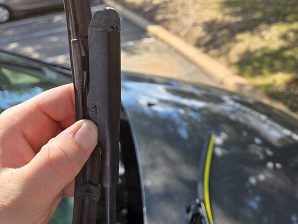

    4. 2015 Ford C-Max Windshield Wiper Replacement: step 4, image 1 of 2 2015 Ford C-Max Windshield Wiper Replacement: step 4, image 2 of 2
      • Squeeze the release clips on the wiper adapter while swiveling the clasp outward to unlock it.
      • Perform this action on both front wipers.
      • The first image shows where to press, and the second shows the adapter flipped open.
      • These adapter instructions are specific to the Rain-X Rugged XL wipers. Follow your specific wiper manufacturer's instructions.

    5. 2015 Ford C-Max Windshield Wiper Replacement: step 5, image 1 of 2 2015 Ford C-Max Windshield Wiper Replacement: step 5, image 2 of 2
      • Squeeze the sides of the adapter to release it.
      • Then lift it straight up to remove.
      • The first image shows where to squeeze, and the second shows the adapter being lifted off.

    7. 2015 Ford C-Max Windshield Wiper Replacement: step 7, image 1 of 3 2015 Ford C-Max Windshield Wiper Replacement: step 7, image 2 of 3 2015 Ford C-Max Windshield Wiper Replacement: step 7, image 3 of 3
      • Squeeze the pressure release tabs and rotate the wiper blade outward to unlock it.
      • Once released, lift the blade off the mounting tab to remove it completely.
