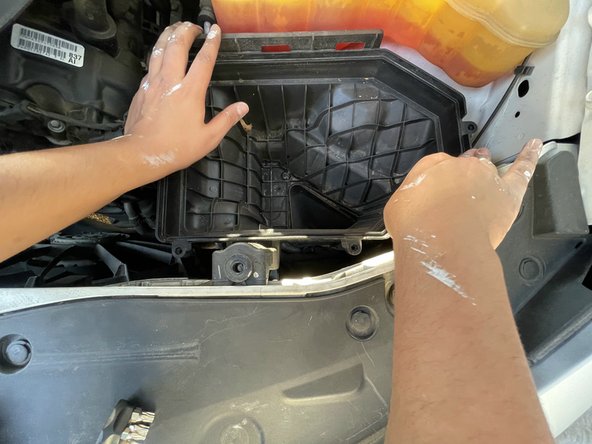

  3. 2015 Dodge Charger SXT Headlight Replacement: step 3, image 1 of 3 2015 Dodge Charger SXT Headlight Replacement: step 3, image 2 of 3 2015 Dodge Charger SXT Headlight Replacement: step 3, image 3 of 3
    • Once the air intake cover is removed, the air filter can be taken out.

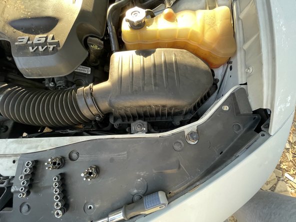

  4. 2015 Dodge Charger SXT Headlight Replacement: step 4, image 1 of 3 2015 Dodge Charger SXT Headlight Replacement: step 4, image 2 of 3 2015 Dodge Charger SXT Headlight Replacement: step 4, image 3 of 3
    • Loosen the bolt using a ratchet and an 8mm socket.
    • Lift the air intake compartment up and out of the engine bay.
  5. 2015 Dodge Charger SXT Headlight Replacement: step 5, image 1 of 3 2015 Dodge Charger SXT Headlight Replacement: step 5, image 2 of 3 2015 Dodge Charger SXT Headlight Replacement: step 5, image 3 of 3
    • Once the intake is safely removed, you can access the headlight compartment.
    • Remove the headlight compartment cap by twisting it counterclockwise.

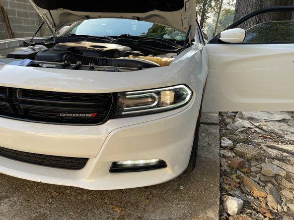

  10. 2015 Dodge Charger SXT Headlight Replacement: step 10, image 1 of 2 2015 Dodge Charger SXT Headlight Replacement: step 10, image 2 of 2
    • Power on the vehicle to ensure the headlight bulb is successfully working.
